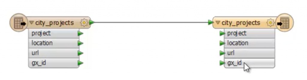

In FME Desktop, this means dropping a GME Reader onto the workspace canvas, then a Writer in the format of your choice, then connecting them.
This FME workspace is configured to migrate data from the city_projects table in the Google Maps Engine Reader (left) to a table of the same schema in the ArcGIS Online Writer (right).

Before loading your data into the destination system, you can modify its schema (i.e. the table names and columns, layers, categories, attributes, allowed geometries, anatomy, physique, whatever terms you use to define the structure of your data). In the Google Maps Engine world, the schema modification you’ll most likely be concerned with is that little gx_id attribute.
When you first put your data into Google Maps Engine, the system appended a gx_id column to your table, which is simply a field containing a primary key. You don’t need this in your destination system. Get rid of it like so:

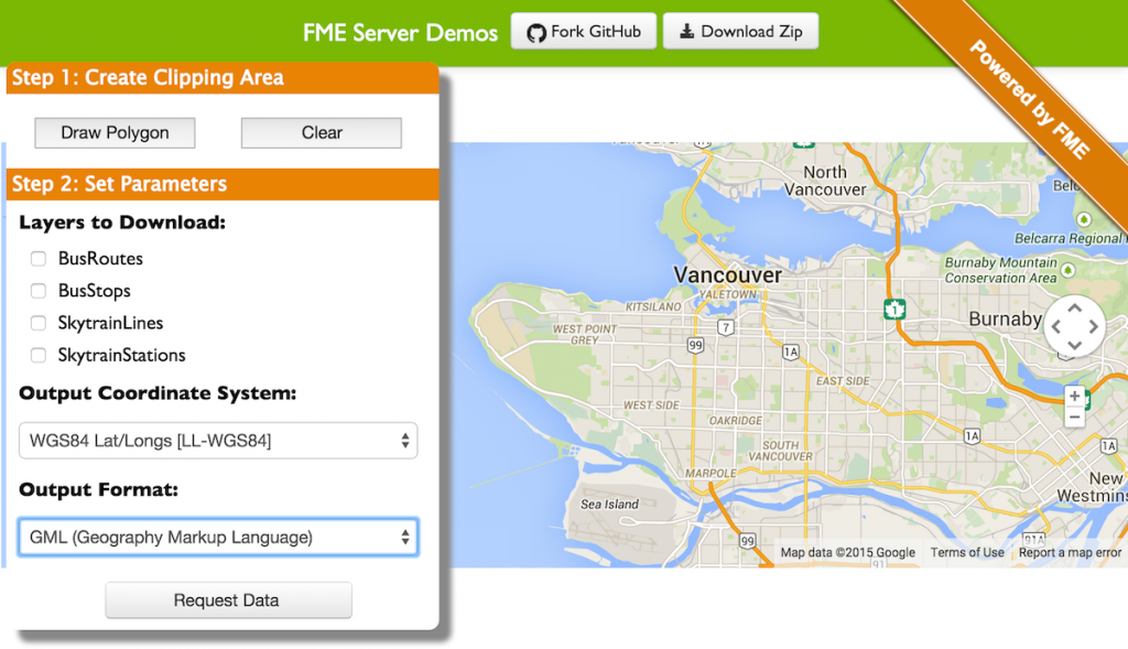

You could even offload the migration task to your end users by creating a self-serve GME access portal. They don’t even need to know how to use FME. To them it’ll look like this:
FME Server Google Maps Data Distribution Example
See how to create this scenario and others in the FME Server Developer Playground.
