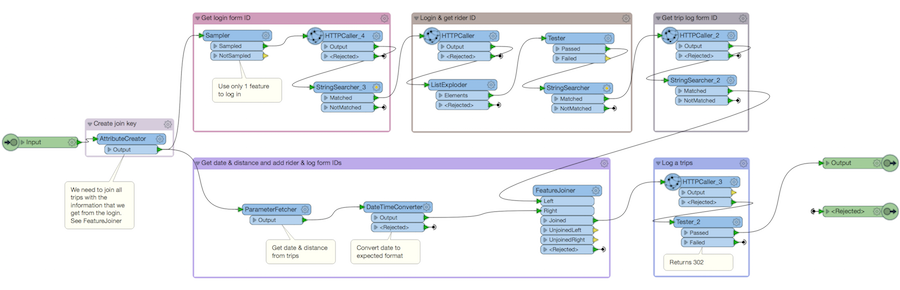

The second step turned out to be a little bit trickier. The HUB Cycling webpage does not provide an API that would allow us to simply log trips by sending a request to a single URL so I had to improvise. But as it often turns out, almost nothing is impossible with FME. I connected a couple of HTTPCallers following the same steps I would usually do manually: Log in to the webpage, navigate to the trip logging page and finally upload the information about my ride. This worked so well that I decided to create a custom transformer.
FME Workspace: A look inside HUBTripLogger, the custom transformer that automatically logs Strava trips to HUB Cycling.

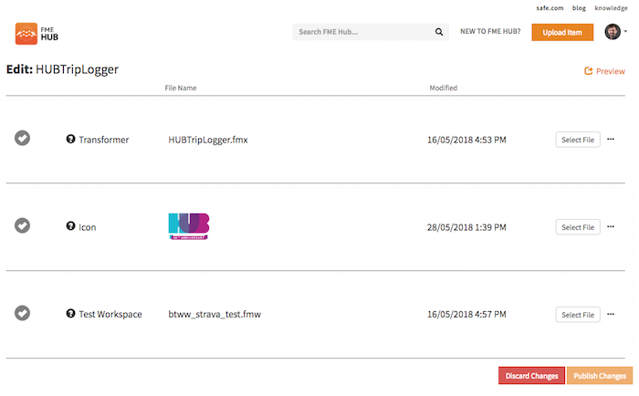

To make the HUBTripLogger custom transformer available to my co-workers and everybody else who wants to log trips with FME during BTWW, I again published it to the FME Hub, which is a great platform to share little projects like this. The new Upload & Edit dialog is very intuitive and walks you through all the steps to upload or update your custom transformers.
The interface on hub.safe.com where you can edit the way your custom transformer is shared.

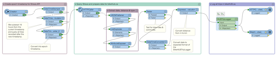

Now if we take a closer look at the full workspace, we can see a few fairly new date & time transformers in action. Working with date & time information can be quite challenging when we work with different formats and web services, and this project is a good example. In total there were 3 common challenges related to date & time information that I had to overcome:
  1. Make sure my request to Strava catches only bike rides of the current day
    Solution: DateTimeStamper & DateTimeCalculator
  2. Provide the timestamp in Unix epoch format for the Strava API request
    Solution: DateTimeConverter
  3. Provide the date in the expected format for the HUB Cycling webpage
    Solution: Again the DateTimeConverter
FME Workspace that logs Strava bike rides in HUB Cycling. [Download here]
Now I had a workspace that queried my Strava account for all my activities and logged all bike rides that were flagged as commutes to the HUB Cycling webpage. The final step is automation.

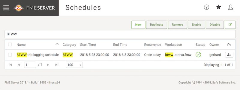

3.  Automate the workflow with a daily schedule
Now that the workflow is ready to get all tracked rides of a single day from Strava to log them as BTWW trips, we need to automate the process for the whole week. So it’s time for FME Server. While not everybody might have access to FME Server, with FME Cloud we can easily launch an FME Server instance within a couple of minutes. With FME Server Schedules we can now set up our workspace to run on a daily basis for a whole week.
Setting up the Bike to Work Week FME Workspace to run on a daily schedule.
Now the BTWW trip logging is fully automated, and all I need to do is track my rides with an activity tracker and let FME do the rest of the work.
