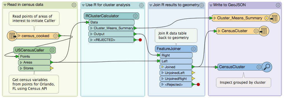

With the last day of Innovation Daze approaching, our team realized that while we could show off our custom transformers, we did not have nice visual results illustrating the power of the RCaller for statistical analysis in FME. Therefore, Sam decided to pull together an example FME workspace in the few hours left in Innovation Daze. Together with FME Technology Expert Nathan, they built an example using the RClusterCalculator transformer and the USCensusCaller to conduct k-means cluster analysis on Orlando, Florida census data. This analysis produced a map with census tracts symbolized by cluster, a little more exciting than a p-value (for some, anyway!).
Example: Creating a Cluster Analysis Map with the RClusterCalculator
FME Workspace using the RClusterCalculator to determine clusters in census data. [Download FME Workspace]
We requested census data using the USCensusCaller custom transformer created by Nate to use the U.S. Census Bureau’s APIs to download census data. The transformer takes points of interest and returns block group features with census variable attributes. We used a slightly ‘pre-cooked’ layer of census block group centroids in Orlando to retrieve the features we wanted.
Next, we sent the features to the RClusterCalculator. We specified the census variables as the attributes to analyze and asked for a 5 cluster solution. Then we used a FeatureJoiner to reconnect the attributes from RCaller back to the geometry using the GEOID attribute from the census. This is necessary because RCaller currently does not support geometry (add your support to this idea to request this feature).

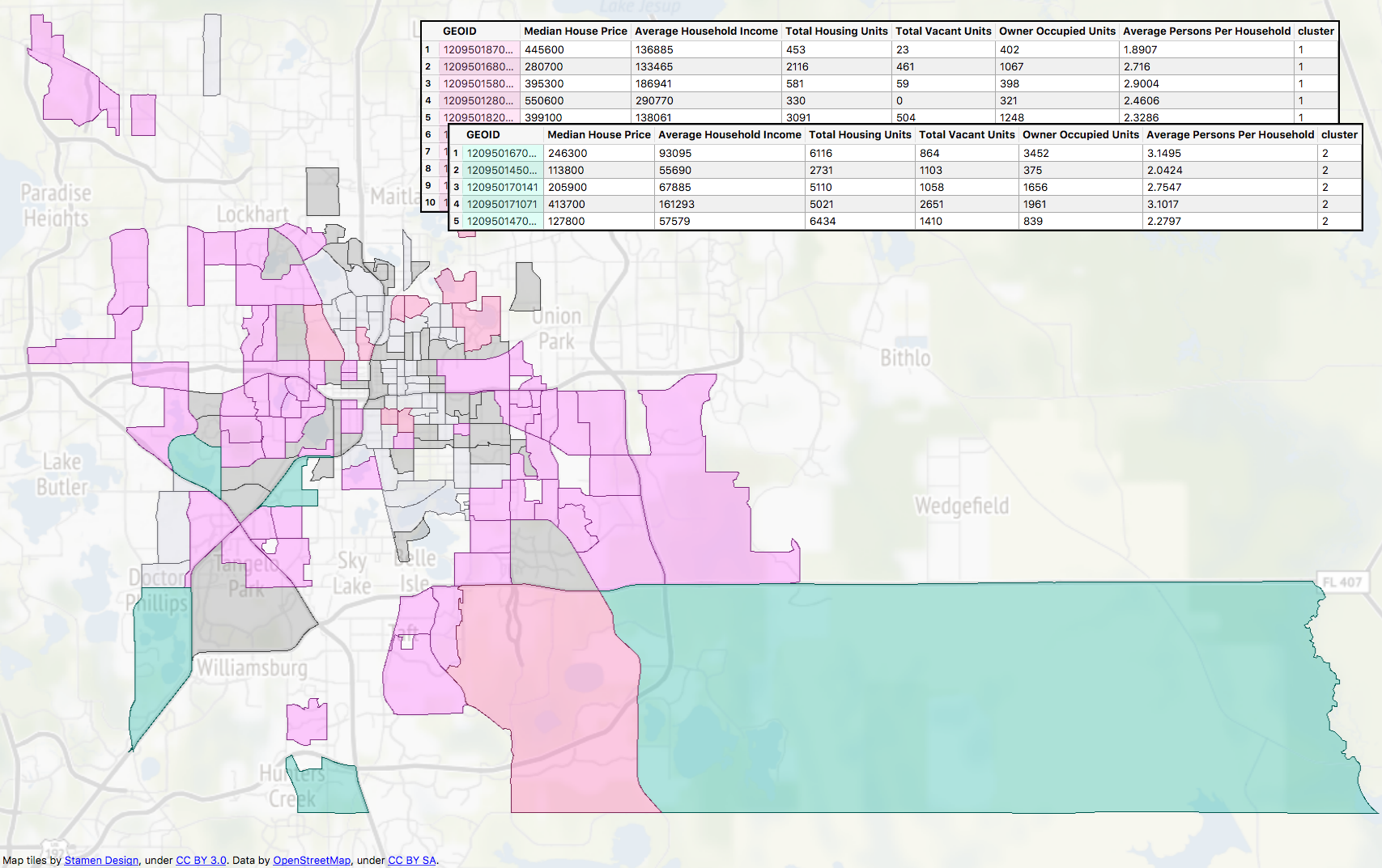

Finally, we wrote our data. The features with the new ‘cluster’ attribute appended were written to the GeoJSON file CensusCluster.json and the means for each census attribute by cluster were written to a CSV table. We used an Inspector transformer to view the data grouped by cluster:
Output of the census clusters. Map tiles by Stamen Design, under CC-BY-3.0. Data by OpenStreetMap, under CC-BY-SA.
